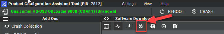

  • Open Product Configuration Assistant Tool on your Windows system.
  • Select provision button

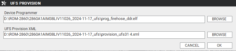

  • Add the prog_firehose_ddr.elf and provision_ufs31.xml in UFS folder.
PCAT2
  • Press "OK", it will start to do USF Provision.

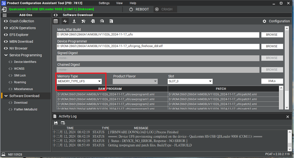

  • Open PCATApp
  • Click Connect A Device
  • Check the device Qualcomm HS-USB QDLoader 9008 (COM11)
  • After check click Connect button to connect
  • When you connected successfully , it will show "qreen word" - Qualcomm HS-USB QDLoader 9008 (COM 11)
  • Select UFS Folder in PCAT Tool , the Tool will help load Files automatically and Select "MEMORY_TYPE_UFS"
Flash1
  • Click Download button

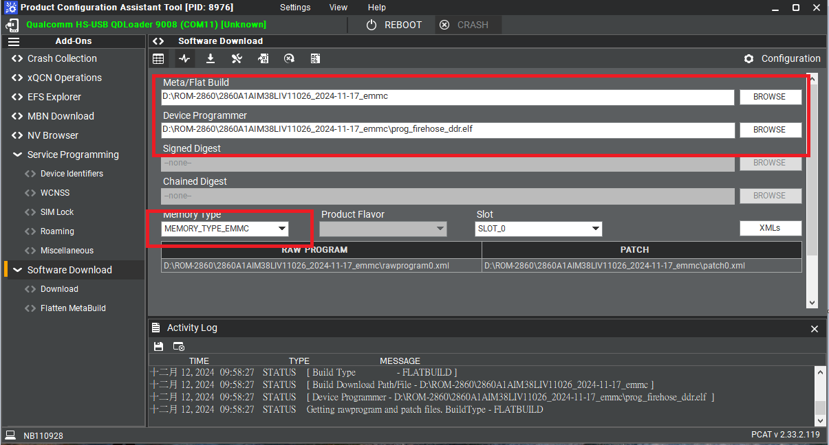

  • Open PCATApp
  • If target device not connect
  • Select eMMC folder , the Tool will help load Files automatically and Select "MEMORY_TYPE_UFS"
Flash2
